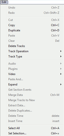

The Edit Menu
Undo
Redo
Cut
Copy
Duplicate
Paste,
Pasting a
Section
Clear
Delete Tracks
Track Operation
Track Type
Audio
Audio Plug-Ins
Video
Paste And
Expand
Get Section
Events
Merge Data
Merge Tracks
to New
Extract Data
Delete
Duplicates
Delete Time
Insert Time
Select All
Set Selection
Track
Type
This option allows any MIDI track to be configured
as a setup-track or a normal-track. A setup-track is a special MIDI
track that only plays once per session to setup your synthesizers. This
is useful if you have long sysex messages that you do not usually want
sent in a long editing session.
Track
Operation Menu
Archive/Unarchive
Tracks
When a track is muted, Metro processes the track while playback is in
progress so that you can un-mute the track without stopping playback.
If you have lots of muted tracks, this can place a heavy load on your
computer. Archived tracks, on the other hand, don't place any load on
your computer. Therefore, if there are tracks you want to keep but
don't need to play, you should archive them instead.
Freeze/Thaw
Tracks
This option allows tracks to be frozen or thawed.
It works only for software synthesizer tracks. Thawed is a track's
normal state. When frozen, a track is converted to audio and cannot be
modified until it is thawed. A frozen track usually saves computer
resoources as the track does not have to be rendered to audio in real
time.
Group/Ungroup
Tracks
This option allows Tracks to be grouped together
so that they are all selected when one is selected.
Video
Menu
Render
Video
Use the render video command (in the video submenu
of the edit menu) to render the current video selection. This reduces
the number of tracks of video to one and is similar to bouncing audio.
