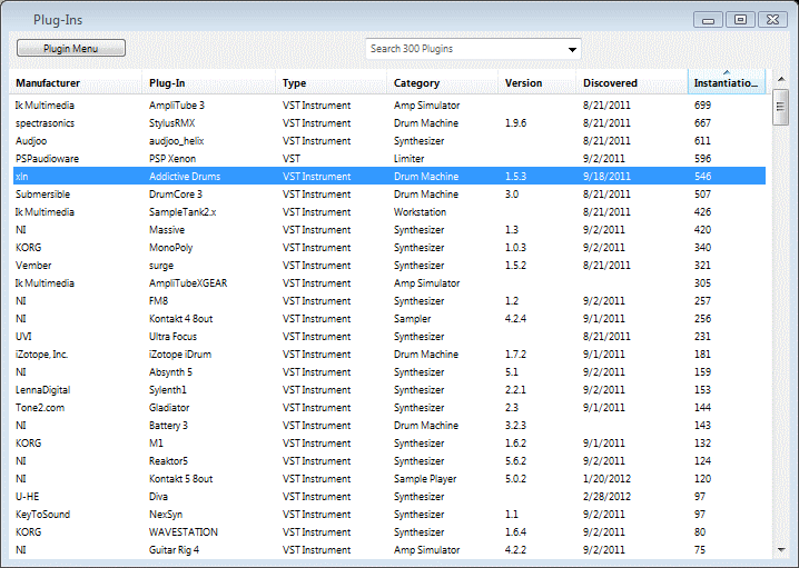

Plug-Ins Window
The Plug-Ins window is basically a library of available plug-ins. Metro supports the following plug-in types:

The Plug-ins window displays all the individual effects available for real-time use within Metro. You can double-click any individual plug-in to add it to a track, aux buss or mixer channel (v7.0) as displayed in the Effects window. Alternatively you can drag a plug-in to the Effects window or to a mixer channel (v7.0), aux buss or master fader in the Instruments Mixer window.

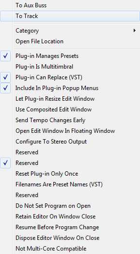

Plug-in Options:
Control-Clicking (mac only) or right-clicking a plug-in will pop up a contextual menu with several options (the Windows version of this popup is shown below). All of the options are automatically saved and are specific to the selected plug-in. Most of the options require the plug-in to be re-instantiated before the setting will take affect. These options are discussed in more detail below:
Select the category of the plug-in from the category submenu. By categorizing your plug-ins you can see plug-ins sorted by category  in the Graphic Editor's, Track Window's and Instantiated Effects/Synths window popups. You can also sort the plug-ins window by category.
The Macintosh version of this menu is similar and includes the option reveal (the plug-in) in finder, instead of Open File Location.
Open File Location / Reveal in Finder
When selected the plug-in will be revealed in the operating system. This works for VST plug-ins. For AudioUnits (Mac Only), since a plug-in is not necessarily a file, the components folder is selected instead.
Plug-in Manages Presets
When this option is checked all preset processing is bypassed and the plug-in is expected to handle all loading and saving of presets. Metro will not search for presets so this option could decrease loading times significantly.
Plug-in Is Multitimbral
When this option is checked the plug-in is assumed to receive MIDI on all 16 channels with each channel producing a unique timbre. Metro will automatically create 16 new mixer outputs when this plug-in is instantiated. If this plug-in is selected from the graphic editor or the tracks window, it will be instantiated on a new aux buss and not on a track.
Plug-in Can Replace (VST Only)
This is the default setting as most plug-ins can accept the VST processreplacing command.
Include In Plug-in Popup Menus
If this option is checked Metro will show this plug-in in the graphic editor, track window and instantiated synths/effects windows. This option is convenient if, for example, you have both AU and VST versions of the same plug-in and you just want the VST version to be visible in popup menus. This option takes affect immediately.
Let Plug-in Resize Edit Window
If the plug-in editor does not resize properly try changing this setting.
Use Composited Edit Window
Some plug-ins work better when their edit window is configured as a 'Composited edit window'.
Send Tempo Changes Early
This option causes Metro to send the tempo changes to the plug-in before the beginning of the next audio packet. Only use this option if the plug-in is not responding properly to tempo changes.
Plug-in Cannot Re-Initialize (Mac AU only)
This option instructs Metro to not re-initialize the plug-in. This works around defects in certain AudioUnit plug-ins.
Open Edit Window In Floating Window (Windows only)
When this option is checked, Metro will open the plug-ins editor in a floating window. This may be desirable in multiple monitor setups. The edit window is not confined to Metro's main window.
Configure To Stereo Output
This option is important for plug-ins like MOTU's MachFive. It will configure the default output as one stereo output.
Non-Apple Generic Editor (Mac Only)
This option forces the plug-in editor to open in Metro's generic view instead of Apple's.
Sample Accurate Automation (Mac AU only)
Leave this option checked unless the plug-in is not responding correctly to automation. AudioUnits have the ability to schedule automation accurately to the sample.
Reset Plugin Only Once (VST Only)
This option causes the plug-in to only be reset once. This option should only be checked if the plug-in does not work otherwise as it indicates a deficiency in the plug-in.
Filenames Are Preset Names (VST Only)
This option when checked (and Plug-in Manages Presets is not checked) causes Metro to use the filename as the name of the preset instead of the preset name which is stored within the .FXP or .FXB preset file.
Plug-in Prefers Carbon Editor (Mac only)
Metro supports both cocoa and carbon plug-in editors. This options selects which one is the preferred interface in the case the plug-in supplies both.
Do Not Set Program on Open
Normally Metro will restore the last preset by sending a program change when a plug-in is read in during an open of a document. Some plug-ins, such as vember audio's surge, do not work properly in this case. When this option is checked Metro will not set program.
Retain Editor on Window Close
Normally Metro will tell the plug-in to close its editor  when the plug-in's edit window is closed. This can save memory as the plug-in should relinquish any resources used by its editor. Unfortunately some plug-ins like, Arturia's Moog Modular and GSI's KeyPerformer, do not work after their edit window is closed. If this option is checked, Metro will simply close the window and the resources used by the editor will stay in memory until the plug-ins is completely de-instantiated.
Resume Before Program Change
This option causes 'Resume' to be called before and program/preset changes are sent to the plug-in. This is not part of the plug-in spec but certain plug-ins like GSI's KeyPerformer, require it to work properly.
Dispose Editor Window On Close
Normally Metro will dispose the edit window when the plug-in is completely de-instatiantiated but in some (rare) cases it is desireable to completely dispose of the plug-ins edit window when the edit window is closed and the plug-in is still processing audio.
Not Multi--Core Compatible
This option, when checked, will instantiate this plug-in on the main thread so that threading issues do not occur. This is important for plug-ins built using SynthEdit as they are not normally compatible with Multi-Core supported digital audio workstations like Metro.
