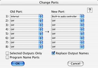

Change Ports allows you to change all and any ports in a Metro file. Use this function when you want to remap output ports. If no Outputs are selected in the Instruments Mixer window, Change Ports allows you to change all references of a given port to a different port. If an Output, or Outputs, are first selected in the Mixer window, all of the Port pop-up menus, except the first field under New Port, will be dim and inaccessible; use the only accessible New Port pop-up menu to reassign all of the selected Outputs to a different port. If Outputs are selected, the Selected Outputs Only check box will be accessible.
Check Replace Output Names to have Metro replace the Output names with the port name followed by the channel.
Check Program Name Ports, if you want your program name lists references to change to the new ports as well.
A port displayed within brackets signifies that port does not exist, or is not defined in the current Metro Output setup. You can reassign any port, including “bracketed” ports, by selecting the former port under Old Port and reassigning it to a different port under New Port.
When OMS or MSS is installed, undefined (“bracketed”) ports will initially display in italics.
exclaim2.gifImportant (OS 9 only): If your source or destination port uses a MIDI Time Piece, then you must specify MIDI Time Piece in the MIDI Setup dialog box (Setup menu) prior to using the Change Ports dialog box. Keep in mind that installing OMS will allow you to custom name each of the 8 available ports on the MIDI Time Piece. Referring to ports by name, rather than number, enhances the overall level of intuitiveness within Metro and other OMS compatible applications.

Change Ports DialogChange Ports
