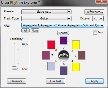

When you open the Rhythm Explorer window you are presented with a pop-up that lets you select a series of algorithms that can be applied to the current selection; the series of radio buttons affects the degree of variability among the algorithms.
Jam
When the Jam checkbox is checked, the Rhythm Explorer will automatically advance the pattern when it reaches the end of the cue. When all patterns are played, it will then generate 8 new patterns and seamlessly continue playing, essentially playing forever.
The Patterns
The colored rectangles numbered from 1 to 8 are different patterns that Metro has assembled according to the selected algorithms and variability. If you click on a rectangle, the current pattern will be played (and looped if cue looping is on). You can audition all of the current patterns in the same manner. To generate a new set of patterns click the Generate button. If you like the previous set of patterns better, click the Use Last button to restore the previous group of patterns. Click the Original icon to restore the selection to its previous, unmodified state.
The particular color of each rectangle corresponds to the algorithm that was selected.
Hovering over the pattern with the mouse shows details on the individual patterns if help tags are enabled from the help menu. Right clicking on a pattern generated by the lead generator provides an option to view more details.

Using the Rhythm Explorer
Use the following procedure to add rhythmic and harmonic treatments to you songs using the Rhythm Explorer:
- Select the notes you want to affect in the current track.
- Expand the Transport window, and enable Cue Looping. That way, when you audition each Rhythm Explorer pattern, you can hear the new pattern repeated many times in a more complete rhythmic context.
- Choose Rhythm Explorer from the Windows menu.
- Click the None button to make sure that no algorithms are selected. (You don't always have to do this, but it's good to start off with simple patterns and move up to more complex ones.)
- Use the pop-up menu to select an algorithm to change the rhythm of the current selection.
- In the Variability field, click one of the radio buttons to change the variability of the selected algorithms. For example, click the Low button to generate a few patterns that are only slightly different from each other.
- Click the Generate button to generate new patterns from the algorithm(s) you selected. Metro generates 8 colored rectangles, representing 8 different patterns derived from the algorithms and variability that you selected.
- Click a rectangle. The pattern it represents starts playing (and looping, if Cue Looping is on). You can audition the rest of the current patterns by clicking different rectangles. To compare the patterns with the original selection, click the Original icon, in the center of the rectangles.
- Now generate a new set of patterns, by clicking the Generate button. If you like the previous group of patterns better, click the Use Last button.
The color of each rectangle matches the algorithm that you select. If you've chosen several algorithms, and you choose higher variability settings, each rectangle may take on several colors to show that it uses several algorithms at once.
When you find a pattern you like, click Apply to alter the selected data.
Now you can save your file, complete with the alterations the Rhythm Explorer made.
