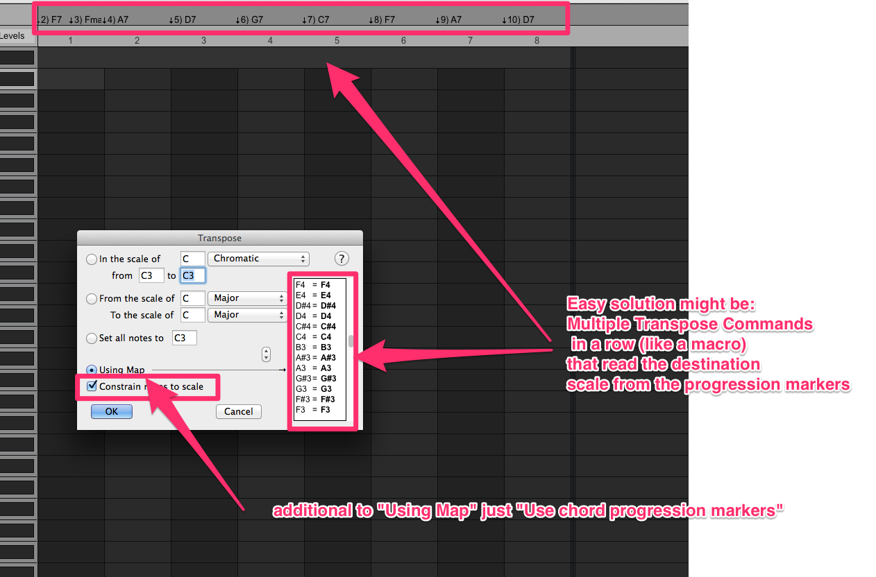

Postby Lytz1 » Sun Jul 20, 2014 2:49 pm
For now and for starters I tried to clarify a possible solution that might be easy to implement via a screenshot that I did.
This would only need the ability to chain several Transpose-Window commands one after the other in some
kind of macro-fashion.
I hope the picture makes it clearer what my thoughtprocess is.
Have a look:
Re: Force to Chordseq Scale
Postby Jerm » Sun Jul 20, 2014 4:28 pm
Yes that would be easy to implement since the most time consuming part of development is usually the user interface.
As for what happens after the user selects 'OK' from the transpose dialog when 'Use chord progression from markers' is selected, it could produce different result every time. Is that what you are looking for or are you wanting it to always do the same thing, basically moving notes so that they pitch-quantize to the closest note in the current marker chord?
Also FYI: The next version of Metro incorporates scales into the markers as well, so it may be that you want to transpose the notes within the scale and/or chord.
