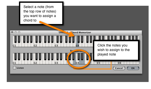

Hey Jeremy,
first , take a look at the picture that I attached, that should explain what it does.
the advantage of having the ability in Metro is the same like with the arpeggiator.
I could use a vst arpeggio as well, but its just not that elegant like the way you have implemented the revolution arp.
With an internal chordmemorizer we could easily jump between tracks and it would be right "in the now". Vst requires setpup and routing
and recording the sequence and so on. Thats not quite as elegant.
And maybe you might even come up with some more crazy ideas
what to do with that concept once the basic one is implemented.. :)
Tonespace for once is too far outthere.I was thinking about something simple, (like in the screenshot) which is fast, fun and easy to work with.
(Just like working with the arp and the rythms in METRO.
SimpleChordMemorizer

Okay I understand now and it seems like a cool idea and should be fairly easy to implement. The downsides are the difficulties implementing the UI and it may be confusing for unsuspecting users.
What is the maximum number of notes that can be assigned to a single key?

well, I dont know the limitations per note, I guess there are none. At least none that I know of in Logic and Cubase.
Actually I think there shouldnt be more notes than needed for a sus9 (plus 2 more for "left hand" ) for example, that would make it a max. of 7 notes per single note played,
thats more than enough. Probably for most uses 4-5 would be sufficient. (and of course the possibility of a preset library to save whole chord-scales for later use. :) )
(Maybe the Metro Keyboard Popup Window where also the Revolution Arp can be enabled would be a good starting point. Propably a second checkbox below the one of the revolution arp to enable a second row of keys for a memorizer?)
