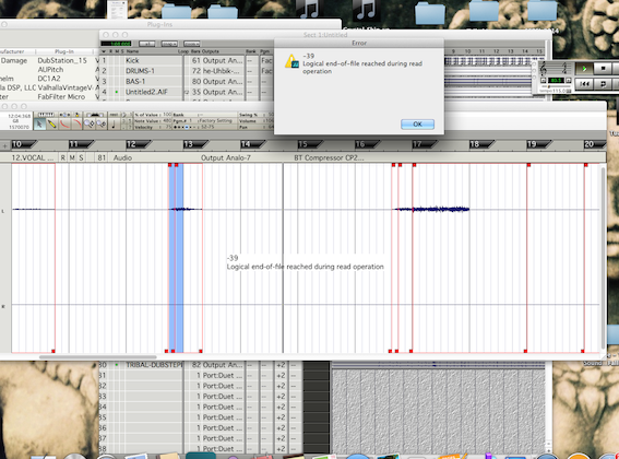

The last time I did a major upgrade of Mac OS and Metro versions at the same time, I had major problems with audio files opening correctly. This time I saved everything as portable bundles as advised, but I'm still having two problems with every old project I try to open and work on.
1.) As stated above, audio plays back where there is no audio in the sequencer. At random points, it seems to latch onto the last bit played and loops it. It seems more likely to do this where there have been micro-edits. I tried copying only a single track where I was experiencing this so I could put in a new project to send you as an example, but once copied and pasted it seems to play back fine. So the only recourse would be to send a bundle of an entire project and indicate one or two places where this is happening.
2.) More troubling is that audio files don't load. While most files are ok, anything that seems to have had prior heavy editing is prone to not load properly. I can see the red region brackets where the audio should be but no waveform. Either that or only the left channel appears (for stereo audio). In either case it triggers an error and halts playback. I'm including a screenshot of what this looks like. This was the same problem I had the last time I did a major upgrade and was told to use portable bundles to avoid it. I saved everything in portable bundles this time, but still having this problem. Going back to check the original files on my old computer, everything is present and accounted for, so not sure what is causing this. The audio data seems to be present in the project folder, it just isn't loading properly.
Frustrating glitch!

Postby Jerm » Mon Aug 11, 2014 4:18 pm
Hello Gio,
Please email a bundle file that exhibits this problem and I will take a look.

Postby Jerm » Sat Aug 16, 2014 4:09 pm
Okay I received the bundle file and found the problem which is indeed a bug when loading certain bundle files. It has been fixed in 7.2.6, which is currently unreleased. The bundle file itself is fine.
A workaround that I think would work would be to use the version of Metro that wrote the bundle file on the new computer to open the bundle file. Save the file as a Metro document and then use the new version of Metro to open the saved Metro document.
