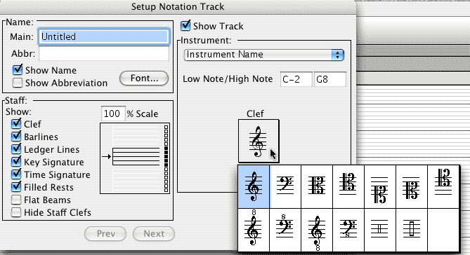

Postby Gerald angus » Sat Jul 10, 2004 9:04 pm
I want a notation setup that looks like a piano sheet, G clef (treble) on top and F clef (bass) on the bottom I have somehow ended up with 2 G clefs and can't change the bottom one to a F or Bass clef. The docs refer to a pop-up menu but can't seem to find it.

Postby Scoot » Sat Jul 10, 2004 9:56 pm
With the cursor tool (arrow) double click on the clef and the dialog box called - "Setup Notation Track" opens.

Postby Gerald angus » Sat Jul 17, 2004 9:09 pm
Scoot wrote:With the cursor tool (arrow) double click on the clef and the dialog box called - "Setup Notation Track" opens.
Yes, I get there too.. but after that, what?
There are no other options at that point to alter any clefs that I can see.
And where is/are the "popup" as refered to in the Metro docs?
Thanks for your help thus far

Postby Scoot » Sun Jul 18, 2004 1:02 am
You have the setup notation track dialog box open?
Click on the clef on the right.
A set of 14 boxes appear with 13 clef options and a space holder in the last.

Postby Gerald angus » Mon Jul 19, 2004 8:14 am
Yes, I can open the "setup notation track dialog box" no problem, but for me when I click on the the clef in the right frame I get NO pop-up with clefs to choose from..
867 Dual MDD gig ram Panther ATI 9000...
any other ideas ?
just does not happen for me.
thanks again..

Postby Jerm » Mon Jul 19, 2004 2:04 pm
As in the above picture, if you click where the arrow cursor is, you do not :? get the clef popup as shown?
Postby Gerald angus » Mon Jul 19, 2004 5:51 pm
Right, if I click there, nothing happens at all. On one occasion a treble clef changed to a treble clef with an 8 under it when I got back to the notation window.... that was a little strange too.

Postby Scoot » Mon Jul 19, 2004 11:12 pm
It would pay to compress and archive the older versions while fault finding. Older documents could open up older versions of metro and Jerm could be telling you it will work (and he may be talking about the newest version with a bug fix) and you've accidently launched an older metro.
This can sometimes stuff up the registration process too.
A clef with an 8 under it is on Jerm's graphic....I'd almost call that progress.
