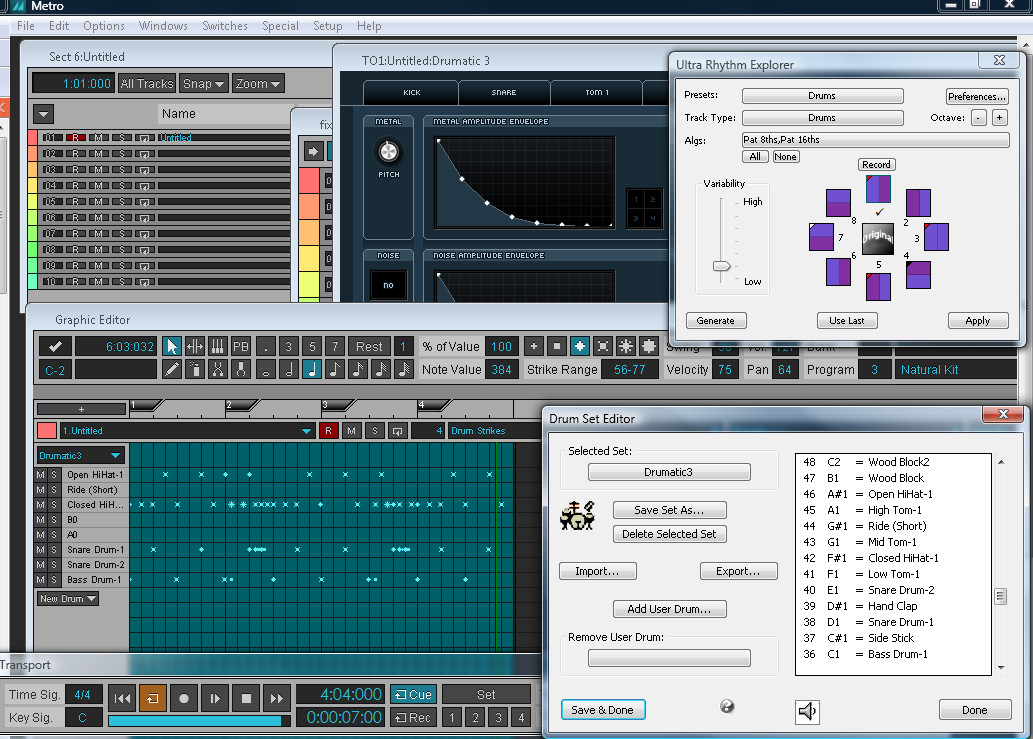

Ultra Rhythm Explorer seems to generate two extra lanes of MIDI that I did not input in my user Drum Set editor for Drumatic3. Notice in the image below the values B0 and A0 when using Drumatic3 [ http://e-phonic.com/plugins/drumatic3.php ]. All values in my user Drumatic3 drum set are set to "unknown" except for the 12 displayed in the attached image.

You can clear them by having no selection (insertion point), clicking on the A0 or B0 and then press backspace. They seem to be harmless. I am not sure how they got there though. Can you give detailed instructions on how to repeat the problem?

Clearing worked as you mentioned.
So I can repeat the behavior only when I create a New drum map and try using it right away. But if I exit Metro and then return it seems to works as should.
Also, I was a bit unsure about the mapping for 3 of my entries [44 med hat = Ride / conga1 = Wood Block ?? / conga2 = Wood Block2 ??? ]
