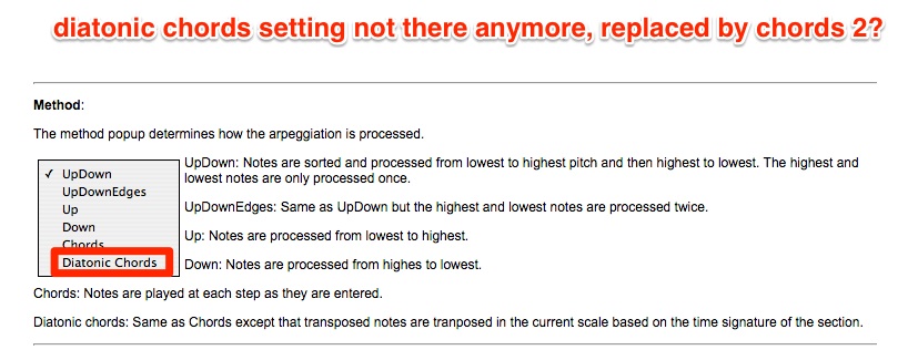

The (old) manual states:
Diatonic chords: Same as Chords except that transposed notes are tranposed in the current scale based on the time signature of the section.
Now we do not have this setting anymore. I guess it's replaced by simply calling it Chord 2. So I assume Chord 2 is the old Diatonic Chords setting.
Now there is also a Diatonic checkbox. Does it do the same for all presets or does it have another funtion?

For clarification which settings I mean I have included a screenshot from the metro manual, see below.
Picture of Diatonic Chords Setting from old Manual

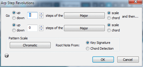

I believe the documentation you are referring to is completely obsolete. Markers are not recognized by the arpeggiator. Diatonic will cause the arpeggiator to select a diatonic interval instead of a chromatic interval. The root note is specified in the arp revolutions page, accessed by clicking on the individual step and selecting 'revolutions...'

Postby Jerm » Sat Jul 18, 2015 3:54 pm
Well most likely you have selected 'root note from key signature' I would imagine.
Re: Revolution Arp Settings question
Postby Lytz1 » Sat Jul 18, 2015 4:12 pm
Haha, lol, yeah, thats it...
