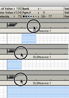

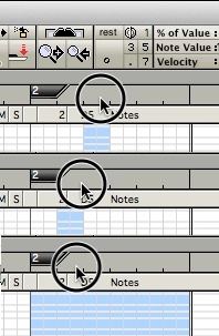

Postby TAUL » Tue Jan 07, 2014 6:24 am
Thank you replying.
Yes, you are correct.
I'm sorry for my poor English. :oops:
I'll attach some pictures about the symptom.
trying to select beat length 01.jpg (34.32 KiB) Viewed 40333 times
trying to select beat length 02.jpg (36.77 KiB) Viewed 40333 times
The result changes In the difference of a delicate positioning.
Can you confirm it?

Re: select beat division in graphic editor
Postby Jerm » Tue Jan 07, 2014 2:42 pm
Thank you for the pictures. I will look into this right away.
What version are you using and what font is selected?
Postby Jerm » Tue Jan 07, 2014 3:10 pm
I am unable to select a full measure by clicking in the beat selection area (white part of bar header). If I click exactly on the beat, Metro selects an insert cursor but never the entire bar. This is version 7.2.
Can you email me the Metro document you are using? Also please tell me the operating system, version of Metro and details of your computer hardware.
