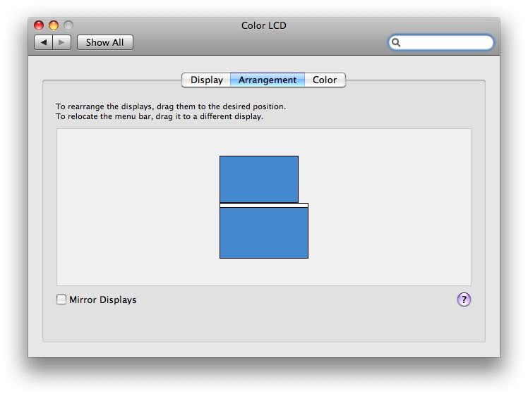

Well I have 2 reports of this but I cannot repeat it. When I click on the tracks window output it pops up exactly where it should. I have a macbook pro connect via the DVI connection and I have mirror displays off.
The only way I could get it to fail was if I set up the arrangement as shown below:
Have you tried messing with the arrangement of the monitors :?:

This problem is fixed in 6.4.9.1 for when the displays arrangement is set as shown above.

Jerm, I haven't changed the arrangement of the monitors but it is quite similar to the one you posted. The second monitor is placed above the first one. I'll check later when you release 6.4.9.1. Any idea when that will be?

Postby Paul » Tue May 25, 2010 1:57 pm
Ok, I have put the second monitor underneath the first one. No problems with picking an output then. I've also put the second screen on both sides of the first one, no problems. So, the problem only appears to exist when the second screen is on top of the first one. What I see happening with that arrangement (I hadn't noticed before) is that the output selection screen in some situations pops up on the top part of the first screen. Sometimes it's empty, sometimes it contains actual output values.

Yes. This problem is fixed. It was indeed a bug. Metro's popup menus were mistakenly assuming that y-coordinates < 30 were off the screen.
